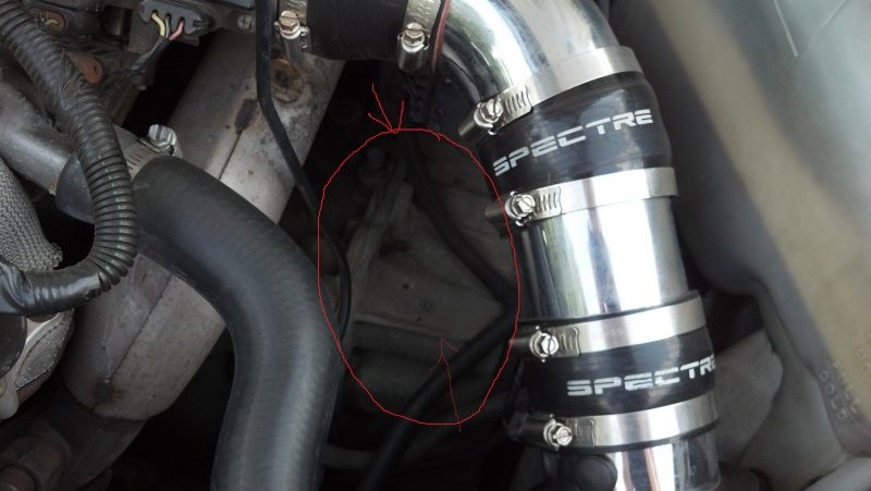

thank you AA. checked the power steering fluid and it was fine, so still not sure what the grinding is. Happens when im stopped at reds lights mostly, if that helps at all. I got a picture of where the knocking is coming from, so ill post that right after this.

circled area is where the knocking comes from. Grinding noise and Knocking 2012-011

another tc bites the big one.

transfer case? :/

Are you sure it's coming from the transmission? Hold a screwdriver to your ear, or use a mechanic's stethiscope to make sure. Sometimes the intake can sound like it's coming from the area you're suspecting.

im pretty sure thats where its coming at, but ill try to try that tomorrow when im working on it and let you know

torque converter. The tc has a lockup clutch assembly in it and it can fail. I think additives with the wrong friction modifiers hasten the failure but I can not prove that. I think Dexron VI fluid, no additives, is the best way to go with these transmissions but I can not prove that. The location you point to however is the 'bell housing' which houses the torque converter. Methinks your tc is "grenading" and could stand replacement. The part is between 90 and 400 dollars depeinding on what you get and how you get it, plus installation. R&R of the transmission may run $500 to $750. This would be a good time to just overhaul the thing if the tech knows what they are doing.

Assuming you need a transmission - which we don't really know yet until you do some troubleshooting - Yes, but you should have a lift and you should be able to disassemble/reassemble the transmission with instructions. If your torque converter has grenadeed you will need to tear down the transmission and replace at least the fiber plates. (with Raybestos Blue ones if you can find them). The steels are probably OK. The valve body will need to be flushed, filter replaced. Point is you will need to tear it down far enough to ensure that no metal shards remain in there. A good replacement TC with a carbon fiber clutch would be less than $150 to the trade (a Recon unit) and an excellent one would run around $350 - 400. When you put the tranny back together be sure to use Dexron VI fluid with no additives. With mine, I think the modifier that a tech put in caused the lockup to slip, generating excess heat, eventually overheating the transmission and killing the clutch. Metal to metal contact caused the clutch to "grenade" or self destruct by grinding itself to bits internally.
If you don't have a lift, gotta pay someone to do this job. About $500 - $800 of the job is just to remove and reinstall the transmission. Once it is out with the proper tools and parts it's a little tedious but not rocket science to fix. A clean place to work is key.
IF you know a good junkyard it can be very very cost effective to get a used junkyard transmission instead of rebuilding yours.
