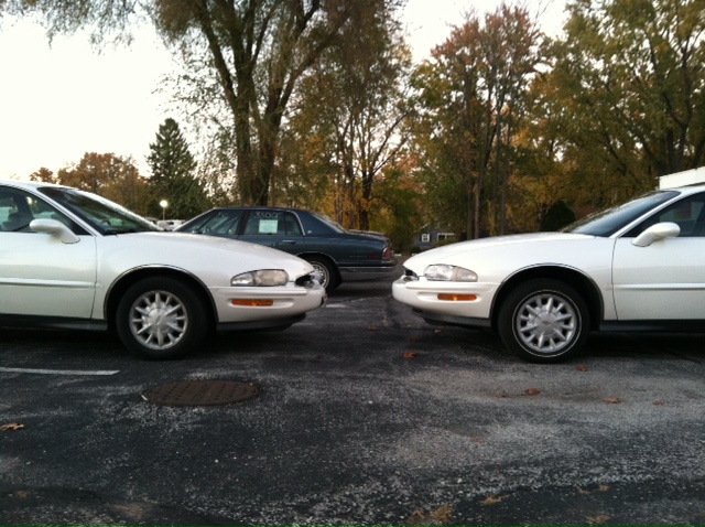

Can you tell which Riv is mine? LOL.
Baby Jesus, please let these Moog springs return my ride to its original height. Thank you.

Moog on the left Monroe on the right Moog's radius is slightly shorter. ID? the thickness of the coil is a mm or 2 smaller than the Monroe.
Putting these bad boys on now and then doing the backs with Moogs.

I put new Moog springs on all 4 corners and now I am back in business. My car has never felt this nice. The only thing I miss is my cornering ability with the saggy oem springs and old struts and shocks. I definitely cannot take a corner like I could with the worn out gear. I traded cornering ability for ride comfort. That's for sure.
Charlie Robinson's '99 Riv - Page 2 Empty
PostSubject: Re: Charlie Robinson's '99 Riv   Charlie Robinson's '99 Riv - Page 2 EmptySun Oct 21, 2012 2:11 pm
Assuming this means your ride height is back to an acceptable level. That's good.
I wonder if this "cornering ability" you're missing is actually real, or if it's just the way you perceive it. Maybe share some details, exactly what is happening that makes you feel your car doesn't hold the corners? Does the car roll a lot? Does it actually loose grip and slide? Understeer/oversteer? Why is it not as good now?
Understand that you've been through a lot with the front suspension, but bottom line is you swapped out your 135k-mile-old stock MacPherson struts and coil springs with fresh Monroe struts and Moog coil springs. Your OEM suspension did not have what I would call "good cornering ability", even if it seemed "ok". Would it be correct to say either the Monroe struts or the Moog springs are giving you a softer ride now compared to stock? That would be pretty soft.
Did anything else change during the process? Are tires the same?
I should have taken pictures before I messed with anything. But here's my best guess. There is for sure a difference in cornering now. Much more roll than before. I was losing grip real bad when I put the monroe quickies on but before I swapped in the Moogs. They have seemed to help with the grip. My thought is that the old suspension i had, while not broke or critically bad, just old and bumpy, was much lower than it is now. Hencea lower center point of gravity and better cornering.
It's for sure firmer.
nothing else changed.
The ride is much smoother now with Moog springs and I am getting much better traction. Not perfect, in my mind, but the best i've had in this Riv. I still think the front is just a bit too high and now im getting paranoid that the entire monroe strut is off spec and not just the spring... hopefully it's all in my head. Check out the pictures below. It seems like the ride is straight level and front needs to drop another inch. The new rear springs helped bring the back up a bit and level it out, thank goodness.I am going to give it a week and see how it settles. I might lift the back air shocks up just a bit to get more weight in the front. Just a wild guess, but, I would say 48.8% of the weight is in front right now. I would like it to be about 51 or 52%.
