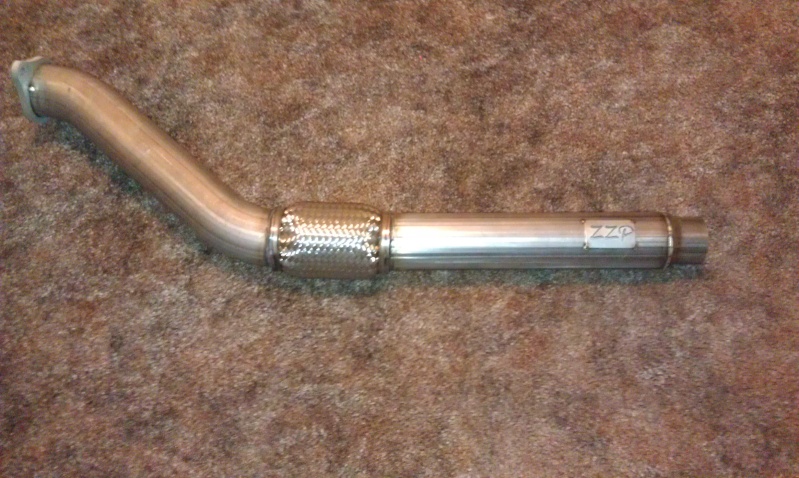

PostSubject: Re: Charlie Robinson's '99 Riv   Charlie Robinson's '99 Riv - Page 3 EmptySun Feb 17, 2013 3:17 pm
Got this brand new, never used, ZZP 3" DP for $100. Retails for ~$200. Craigslist is awesome, isn't it?

PostSubject: Re: Charlie Robinson's '99 Riv   Charlie Robinson's '99 Riv - Page 3 EmptyMon Feb 18, 2013 9:58 am
Is that down pipe for bonneville?

PostSubject: Re: Charlie Robinson's '99 Riv   Charlie Robinson's '99 Riv - Page 3 EmptyMon Feb 18, 2013 10:06 am
Shore is! pimp It's got the O2 bung hole on the otherside too.

PostSubject: Re: Charlie Robinson's '99 Riv   Charlie Robinson's '99 Riv - Page 3 EmptyMon Feb 18, 2013 10:07 am
Oh nice so are you welding it in or? Do you know what gaskets we would need if deciding to bolt in?

PostSubject: Re: Charlie Robinson's '99 Riv   Charlie Robinson's '99 Riv - Page 3 EmptyMon Feb 18, 2013 11:13 am
I am doing a 3" gasket bolted to the collector/dump off the back manifold. then im going to clamp the 2.5" end of the downpipe to a 2.5" resonator that will be clamped to the rest of the 2.25" plumbing.
Hope the exhaust sounds decent when i'm done.. I don't want to weld anything so when it's time to modify again it will be relatively painless.
