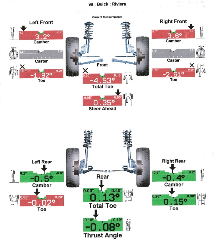

PostSubject: Re: Charlie Robinson's '99 Riv   Charlie Robinson's '99 Riv EmptyMon Sep 24, 2012 11:06 am
Ok. So. I didn't want to mess with compressing the strut springs so I took it to the neighborhood performance garage. We open up the KYB strut boxes and I get 1 black GR2 and 1 silver excel whatever updated model or something. Thanks, KYB!
The garage will not install this mixmatched parts on my car. Even tho they appear to be identical besides the color, the refused. My car was jacked up and I am on the pay clock so I had to find struts, fast.
I opted for a pair of Monroe sensa track one piece struts. $220 EACH! OMG. Replaced a bad outter tie rod,alignment, and the labor took my bill to $480... Plus the monroe struts, and I was pushing $1,000. for front end struts.. yikes.
Rockauto, I will be calling you about a refund today for the KYBs..
Anyways, wow. Night and day difference. The car feels like it has more muscle and a much firmer stance. Then handling has greatly improved. The one piece monroe assembly comes with new springs, of course, and I think they may have something to do with it, but my front end got a lift! I would say its about 1.5"-2" higher than it was before.
Here's a side shot.
Charlie Robinson's '99 Riv IMAG0512
Here is what my alignment looked like before and after. OUCH!
BEFORE:
Charlie Robinson's '99 Riv Before10
AFTER:
Charlie Robinson's '99 Riv After10

But what about the ride height? Does that look normal to you guys? Will the new springs chill out after a while and come down a bit? It is definitely lifted in the front. Can't say I hate it either.
PostSubject: Re: Charlie Robinson's '99 Riv   Charlie Robinson's '99 Riv EmptyMon Sep 24, 2012 2:56 pm
Are you saying the supplied nut didn't fit the strut it came with? The threads are different than OEM, so you can't re-use the stock nut, but I've always had good luck with the supplied hardware.
Your front end looks high. That's one of the drawbacks to all-in-one spring/strut combos. They probably use the same spring for a variety of different cars, even though the struts might be different. In other words, the spring rate is likely different than our OEM spec, because this spring could be used for more than a few cars, all with different curb weights.
If it were my car, I'd be 10,000X more concerned about the ride height issue than I would be about the GR-2/Excell-G paint colors not matching. Your mechanic was kind enough to not install your product, but they were more than willing to jack your car up 2" high in the front by installing their parts and charging you a lot more in the process. A mechanic friend told me a long time ago: shops make most of their profits from selling parts, not on labor. For this reason, very few will install parts brought to them by the client, because it's not worth their time. Seems like this held true in your case, imo.

These were not their struts. I picked them up at O'reilys. Only place that had the only strut that would fit on that Saturday. They didn't install any of their own parts. Just charged me for labor.
I have no complaints so far, just wondering about the lift in the front. Anyway I can lift the back a little? If I use that remote line instead of the pump can I do it manually?
PostSubject: Re: Charlie Robinson's '99 Riv   Charlie Robinson's '99 Riv EmptyMon Sep 24, 2012 3:28 pm
You can lift the rear up with air using the manual air valve. Then you could try filling out the wheel openings next time you buy tires, going with a 65 or 70 profile. Or just go with 18" wheels and a set of 50 or 55 profile tires.
Honestly though, the new tires will cost more than putting the old springs back with your new KYBs - if you do it yourself. I'm guessing since you didn't use their parts, the shop isn't going to take any responsibility for the ride height at this point. I like riding stock height or lower than stock height, but if you don't mind riding high, maybe lifting up the rear is the better solution.
If you value handling, generally it makes sense to keep the car riding as low as possible, but not always (slamming her to the ground will not make a race car). Mine handles pretty well with the rear a little high. Never tried raising the front.

PostSubject: Re: Charlie Robinson's '99 Riv   Charlie Robinson's '99 Riv EmptyTue Sep 25, 2012 1:15 pm
I would be very concerned about that ride height. Something is not right there. It looks unusual. I'm not sure what to expect, but the ride height really shouldn't have changed at all.

Ok. So the monroes were installed on 9/22/12
Here is a picture from 9/24/12
and then on 9/26/12
Charlie Robinson's '99 Riv 110
It feels like the front has settled down a bit, maybe a quarter to a half inch. But the worst part is loss of traction on the front wheels. Too much weight has been tipped to the back. I can't get my awesome launches from a stop anymore frown
I would be worried about the negative effects on the cars handling.
Should I take it back to the garage? The handling is amazing compared to what it was. The car feels stronger with more beef in the front. Only downsides i've noticed is that I can't take turns as fast as I could with the older worn struts and I lost some traction in the front. The grip just isnt there like it was.
PostSubject: Re: Charlie Robinson's '99 Riv   Charlie Robinson's '99 Riv EmptyThu Sep 27, 2012 3:26 pm
I think so. Any mechanic who looks at that will recognize something isn't right. The car should sit level, and at the correct height. Either the replacement struts had the wrong springs, or someone swapped the springs over incorrectly, or something. I replaced my struts and reused the original springs, and 80K later they are still at the correct height and the car handles good.
You already pointed out the obvious handling issues - both launching from a stop (FWD is more sensitive to this) and cornering will be badly affected by increasing the front ride height.
You may be able to return the struts to where you got them. Any parts counter guy should be able to take one look at your car and realize the part is wrong. They may not be willing to absorb the labor costs, but they should accept the part back.
Just to clarify - you got a complete strut kit, with the strut, spring and strut mount all included? Monroe? Something called a "Quick Strut"?
