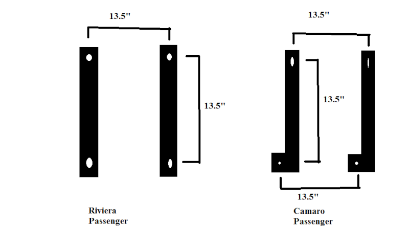

While doing my friends seats in his 3rd gen Camaro, I measured the brackets for the fun of it. Keep in mind the seats from a 4th gen will just bolt right in to a 3rd. The mounting holes brackets were 13.5" apart lengthwise and widthwise. From what I could measure on our seats the dimensions are pretty close (if not the same). The only issue is that the mounting holes are offset for the Camaro while ours are straight (see diagram below). I'll pull my passenger seat sometime soon and see if his old one fits.

PostSubject: Re: Seat swaps - bracket compatability   Seat swaps - bracket compatability - Page 3 EmptyThu Jul 16, 2015 5:03 pm
Would you be able to drill a hole in the Camaro bracket that would make it fit into the Riviera?
Possibly. I think they'll fit fine and will just have a slight angle to them. The front holes in the Camaro bracket are slightly slotted which could make fitment a little easier if they need to be elongated at all. Will update with pics soon.

Our bracket fits perfectly onto 3rd gen seats, motors and all. 3rd gen brackets fit onto 4th gen seats, sooooooooooo......... They're lighter with the rails/motors than one of our seats without the rails/motors. You have to swap our bracket over because it turns out ours has hooks in the front instead of bolts, but by doing this you retain forward/back/up/down/tilt control, then use the manual adjuster on the seat for the bolsters and how far the back of it leans. If you got creative you could find the seat adjusters for a 3rd gen and wire them in, the motor assemblies are virtually identical. I think they would look amazing if they weren't ripped to shit and matched the color of the interior. The seat belt loop thingies were also broken so it chokes me at the moment.

awesome! i am not familiar with the seat mounting brackets at all but, how would this work with aftermarket universal seats? Would you mount the universal seats to camaro gen 3 brackets and then they would bolt into the riv? dunce

No, this is all Rivi brackets bolted onto the bottom of the Camaro seat. To adapt our bracket to an aftermarket seat you're probably going to have to manufacture some special adapters. Your best bet is to figure out what seats bolt to Camaro brackets because they will also bolt to our brackets. If you want lightweight but sacrificed comfort I would go with these or 4th gen seats because they are factory rated for safety, it's hard to say if seat XYZ is. If you want something with a little more bolstering than stock but still good comfort I would do the Firebird seats. Take a day trip to a junkyard and start pulling seats from GM cars that you like and measure the holes on the bottom of the seat, not the bracket. If the holes are ~13.5" x 13.5" it should work.
