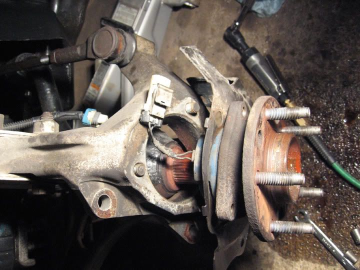

5) caliper bracket and rotor (15mm) Here is a pic after brake caliper and rotor were removed. I removed the caliper and brake hose (vac pump holding pressure in line), but you can simply hang or zip tie the caliper up and out of the way:

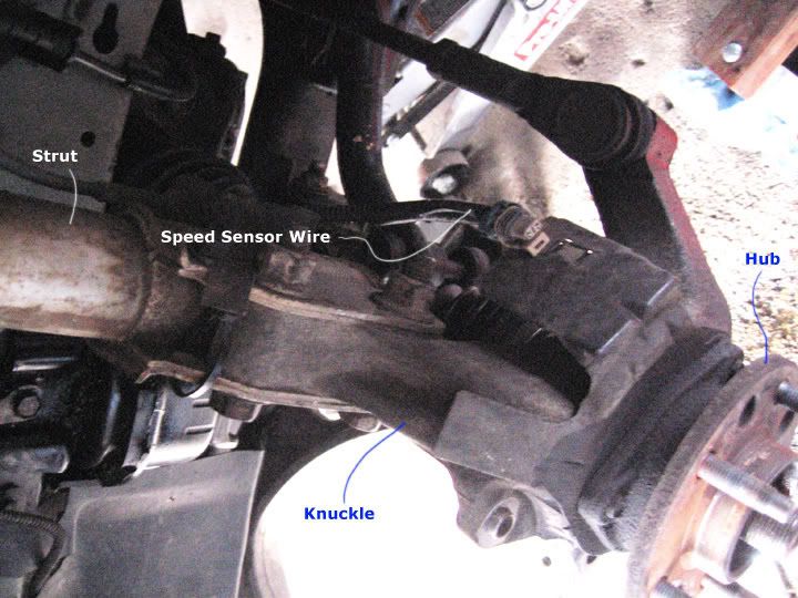

5 1/2) Disconnect speed sensor wire, shown below:

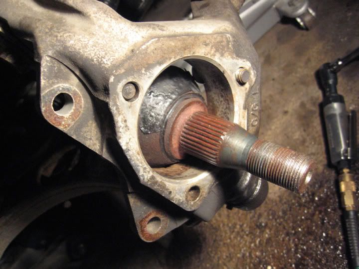

6) with soft hammer, knock axle inward to free splines. (don't try to remove, just free it). If you don't have a soft hammer, put the nut back on flush to the end of the axle to protect the axle's threads. In fact, if you don't have a soft hammer I'd be reluctant to try it this way. I've found these hubs can be a PITA to get off. In my case, the axle was basically welded into the hub. If your bearing is going bad, chances are it gets very hot when spun, so it can seize to the splines over time. You can rent a puller tool from Advance Auto Parts for free, but I've managed to break them on two separate occasions. Below shows the tool in operation. BEWARE: when you use this tool, lots of force is involved, so something's got to give: 1) the axle (hopefully), 2) the lugs/nuts, or 3) the tool itself. Wear eye protection, and stand clear! I was sitting beside the wheel once, tightening the tool, when a lug nut broke away from the lug and hit me right in the chest with considerable force. Had this been my face, I might have been knocked unconscious.
If the above tool doesn't seem to work, or you don't have one, try the soft hammer. If that doesn't do it, take a small sledge and tap the axle in with the nut on the end to protect the axle threads, per deekster's instructions. Do not pound on the end of the axle without the nut in place, or you likely will not be able to thread the axle nut back on.
If it's still not coming off, make sure to spray the axle again with PB Blaster and let sit a while. Try tapping it again, HARD. You can tell when the axle starts to move because it will sound different. If still no success, try using a butane torch to heat up the outside of the bearing:
After heating and some hard pounding, it should eventually start to move. You may damage the axle nut in the process ($7 at the dealer, surprisingly NO auto parts stores carry them). Here's what happened to mine; you can imagine how much force it took to do this:
Not to worry, the threads are from the nut, not the axle.

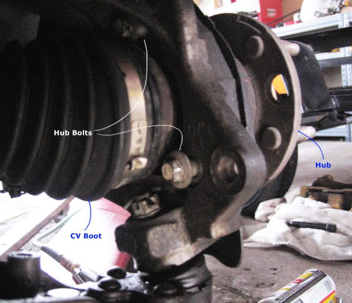

9) unbolt bearing (13mm) Once the axle and hub are freed, you can unbolt the bearing. Here's a look at the bolts from the back side. There are three total:
10) smash old bearing outwards. This is why I choose to take the CV shaft out first. Aluminum and steel corrode to each other badly. Be careful of the steering knuckle, it's only aluminum... The way I did this was to loosen the hub bolts, then tap the axle through, then loosen some more, tap some more... The hub will just slide right out:

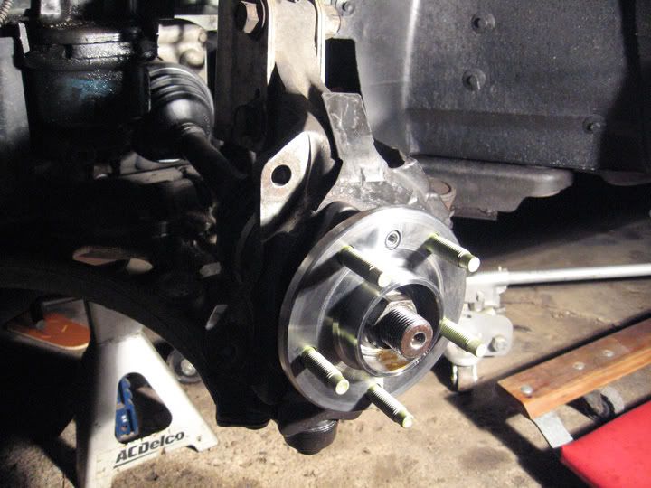

14) lower ball joint in. tighten nut until it's really tight and the cotter pin lines up. Can't put a torque wrench on it because CV joint is in the way. Insert and bend NEW cotter pin safely. (reusing cotter pins is a death wish)
New hub installed:

Hmm, still need to confirm those two torque specs, plus I forgot to write about the ABS wires. It's just unplug/plugin, depending on the bearing you got you may need to do something with the wire holding clip.
