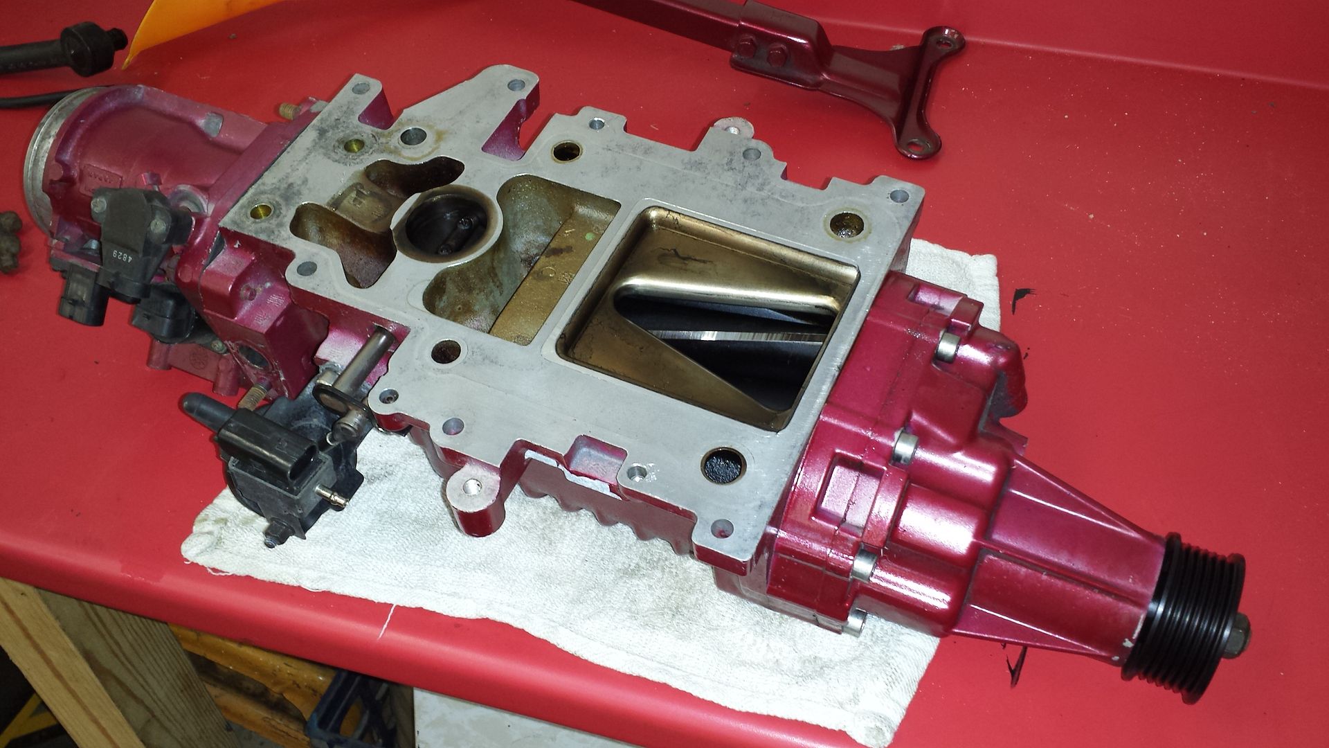

| Hello again, Well I had some time the other day to get my supercharger off to replace the coolant sender for my gauge and re-seal the metal coolant pipe that goes into the LIM. I think I may have set some sort of record. I had all the vacuum lines, wiring, supercharger, and fuel rail off within 35 minutes. I also wanted to take this time to check out how Karma's magnificent porting and blockoff plate were holding up, and they look fantastic! Just a light coating of...whatever. Probably just a bit of oil, and it wiped right off and polished up again in no time. Thanks again Karma! It's truly a work of art! I opted to try a new sender for my temp gauge just for fun, and it installed fine. This picture is of the old sender on the left and new on the right. Different length, sure, but same construction and no problem with fit. Notice anything funny about the threads at the top where the wire connects to? If you look close, you can see the new sender is reverse threaded. What the hell. So I cleaned up the old one as best I could and installed it with new Copper RTV. Still does not read correctly, but at this point it must be a wiring issue from when I did the swap. That's for another day when I feel like digging into the dash. Everything seemed to seal up great and went back together with no problem! Now just waiting for some less-rainy weather so I can drive the darn thing. Also, I thought this was funny. Test drove the car did errands at the same time so I picked up lunch for me and Dad since we were doing work on another car later. Kept his Sonic burger warm with the engine bay haha. | |
