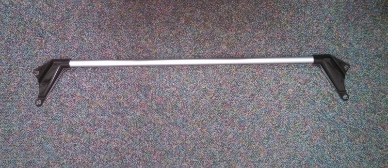

Just got my Cadillac STS front brace back from my buddy who powder coated it for me after I was done with the "dremel-ing" of the mounting holes and "denting" the underside to clear the brake fluid reservoir.  I'll be installing it tonight most likely since it should be a 15 minute task.
We could have just coated it solid black, but since he had some left over silver powder lying around, what the heck.... cool
Write-Up: Installing a Front Strut Tower Brace (STB) - Page 24 Stb-sm11
Write-Up: Installing a Front Strut Tower Brace (STB) - Page 24 Empty
PostSubject: Re: Write-Up: Installing a Front Strut Tower Brace (STB)   Write-Up: Installing a Front Strut Tower Brace (STB) - Page 24 EmptyThu Jun 13, 2013 4:37 pm
Did you install and drive with it prior to powder coating? If not, prepare to be amazed! It feels GREAT.

Awesome work, Al. I was actually thinking the other day about doing exactly the same thing! I got as far as removing the STB from my car, haven't painted it yet. Its amazing, your finished bar looks just like I pictured it. Hope you don't me copying your idea.
If I sent my bar to you, how much would your guy charge? I would media-blast prior to shipping.
Age : 54
Post Count : 960
PostSubject: Re: Write-Up: Installing a Front Strut Tower Brace (STB)   Write-Up: Installing a Front Strut Tower Brace (STB) - Page 24 EmptyThu Jun 13, 2013 5:49 pm
No problem, I don't think I would have too much of a copyright on this simple paint scheme lol
I got a really cheap deal since he's my buddy, but called him and said he would do it for $60.  If we had 5+ folks, he would go $50.  This includes his stripping the old paint, masking and coating it.
Now this is in Raleigh, NC so I don't know if shipping it may make this prohibitive though.  You might see if it could be done cheaper locally once you factor in shipping to/from Raleigh.
Heh, I did not.... so we'll definitely see thumbsup
