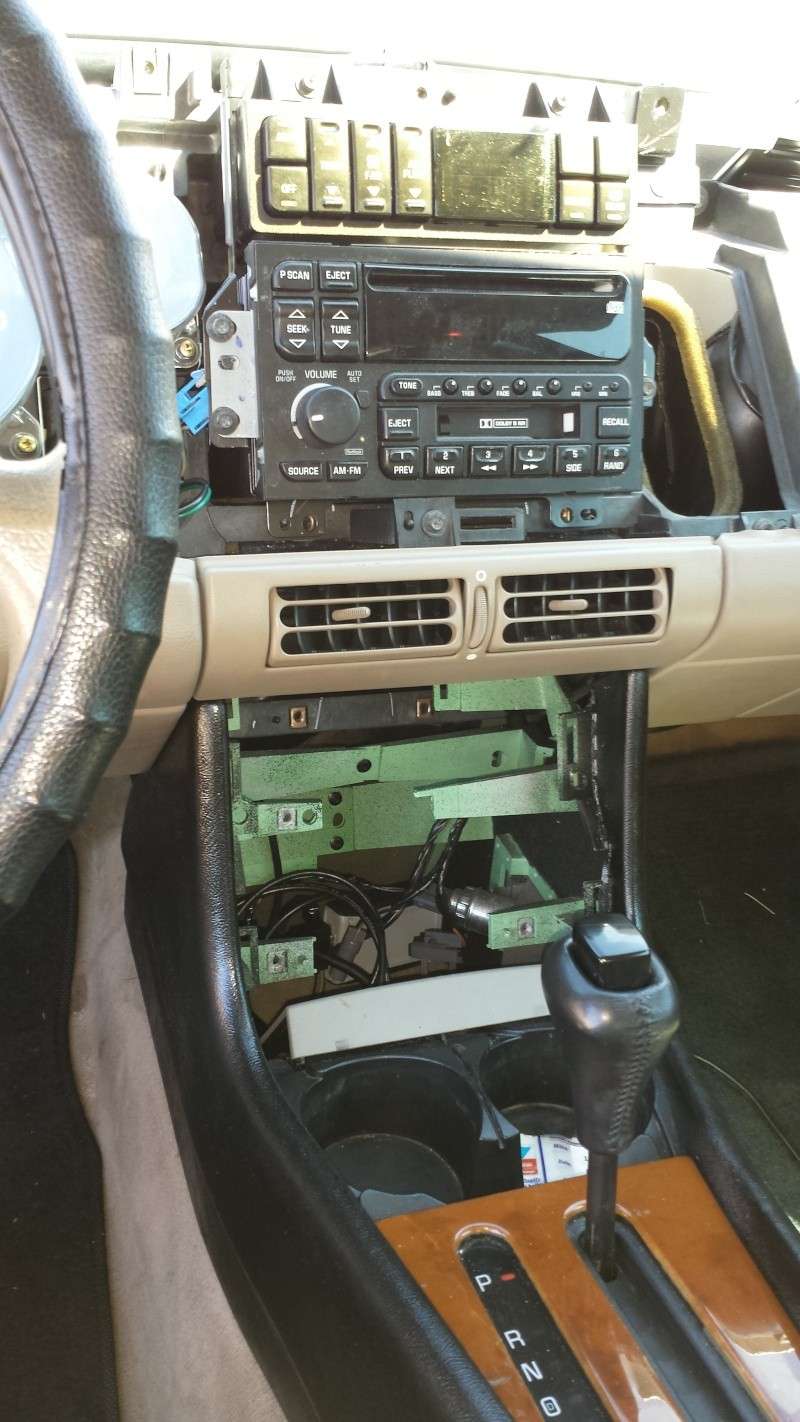

Here is the area I am installing my receiver and HPtuners USB port hub.
CR's stereo Install Thread 20140710
Here is the mock up of getting everything ready for install
CR's stereo Install Thread 20140711
The cig port will be used for HPtuners USB hub but I am not sure what to do with the old ash tray window..yet...
