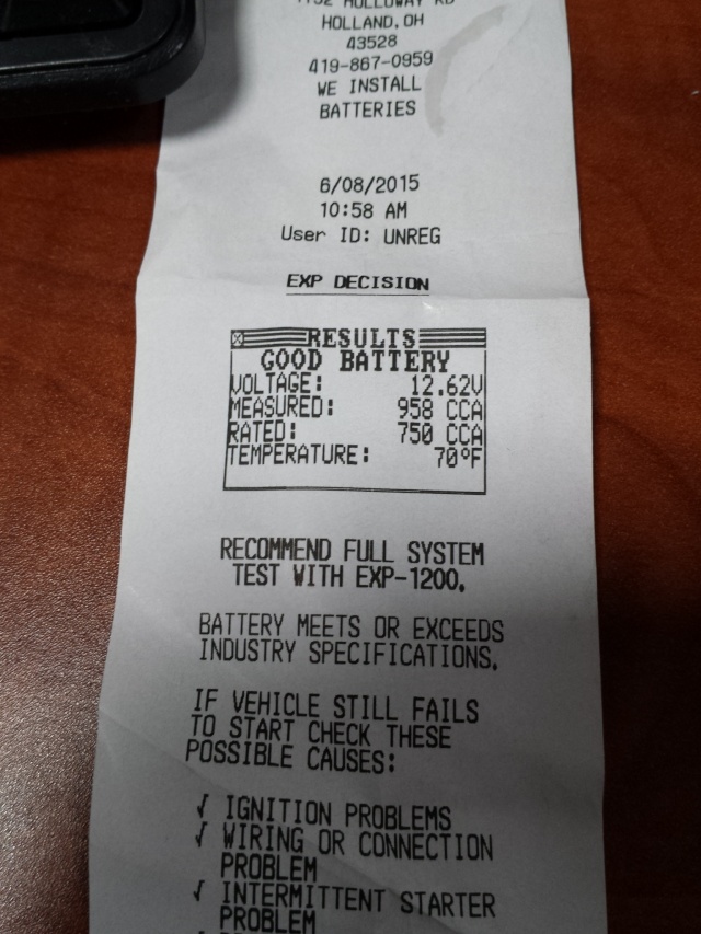

Dang. Advance said they couldnt scan it. HPT doesnt show anything for it.
Advance ran their diagnostic whatever on my battery and alt. Test came back good to go.
Riv starts up perfect and runs fine with everything turned on high. But the red light wont go away.

Red Battery Dash Light ON! Img_2015
Red Battery Dash Light ON! Img_2016
