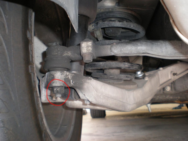

how do you remove the rear springs??
i got the spring compressor on, but even with the spring compressed almost all the way, i see no way to get the spring out. it needs to move another inch+ to clear the rubber thing in the center. there must be a way to fully drop the rear A arm. anyone who has replaced the rear springs on a riv care to chime in?
TIA

Did you disconnect the rear shock?
FAQ: Aftermarket Lowering Springs - Page 5 Empty
PostSubject: Re: FAQ: Aftermarket Lowering Springs   FAQ: Aftermarket Lowering Springs - Page 5 EmptyMon Feb 16, 2009 10:03 pm
yes, and it didnt have any resistance holding the A arm up.

1) Did you remove adjustment link from control arm (Rear Tie Rod End)
If so, then lower the control arm until it bottoms on support assembly.
Then pry under lower spring insulator and remove spring with insulator.
Have someone jounce on bumper if necessary to free spring.
It should come right out. I didn't have any trouble and i didn't use a spring compressor nor did I have to remove the Control Arm Assembly.

Disconnect sway bar end link?
PostSubject: Re: FAQ: Aftermarket Lowering Springs   FAQ: Aftermarket Lowering Springs - Page 5 EmptyTue Feb 17, 2009 11:32 am
i have poly links on the sway bar, so i only unbolted it to see if it was holding tension. the bar moved and the arm didnt.
i'll return the compressor today and take another look at unbolting the arm.
thanks for the help thus far.
and here i thought the rear was going to be a piece of cake 10min job.

just to verify that we are talking about the same part here.
if i unbolt the piece in red, the whole rear suspension platform will drop low enough to wedge the spring and insulators out?

YES, that is the part i was talking about. If you do not disconnect it from the control arm, the control arm cannot travel down far enough. You will possibly need a tie-rod or ball joint fork to separate it.
Or loosen nut until it is flush with end of stud and try hitting on that end with a hammer if you don have the proper fork. DO NOT over do it though or things can get all boogered up and expensive.
I would buy an inexpensive tie rod fork at the auto parts store or sears and do it that way.
It sounds like you do not have a set of Factory Service Manuals for your 96, If not I have a set i can sell you. PM me if your interested.
