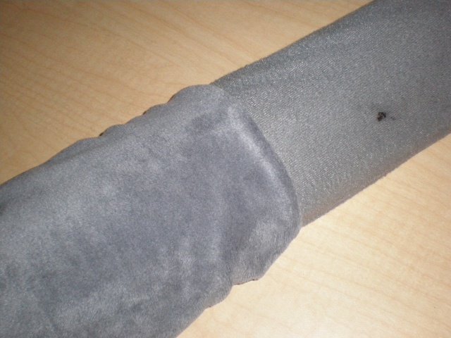

Here is the color/material against the factory light gray interior

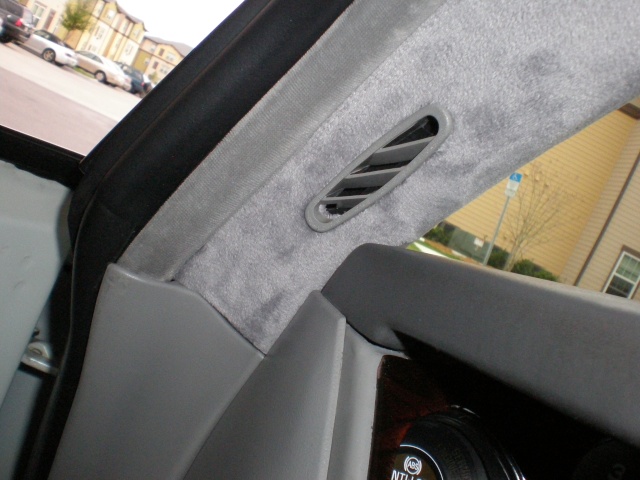

here is the final product:
Write-Up: A-Pillar Re-Upholstery & Guage Pods - Page 2 P4010012
A few last word of wisdom; there are 2 tabs on the bottom of the pillar that just slide into the top of the dash. they are thin and fragile.
also, when reinstalling, it is easier to separate the pins into 'screw & tab' install the tabs on the car, then install the pillar with the screws in place.
the material feels so nice and it looks factory IMO. i was going to do fuzzy leopard print fabric, but im glad i stuck with the factory color wink

one more pic of it installed:

Sweet! Nice pics and writeup. smile
Write-Up: A-Pillar Re-Upholstery & Guage Pods - Page 2 Empty
PostSubject: Re: Write-Up: A-Pillar Re-Upholstery & Guage Pods   Write-Up: A-Pillar Re-Upholstery & Guage Pods - Page 2 EmptyTue Apr 01, 2008 9:45 pm
Excellent! That's a much better alternative to my trying to find ones in near perfect shape from the junk yards. Where did you get the new cloth from and did you see something beige?
