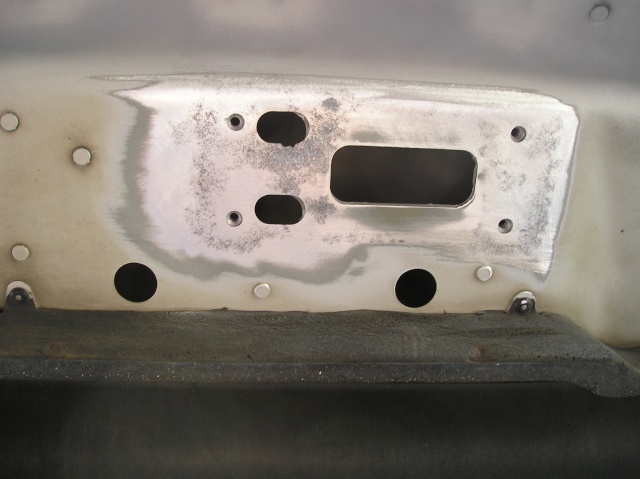

I'll have to disagree here Eric, the "pan" is also aluminum. Riveted to the hood, and then the liner is attached with plastic pins.
The corrosion I have on mine is a good indicator of that!
