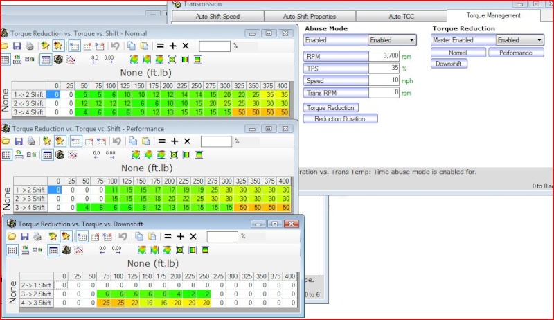

PostSubject: Re: torque management, KR recovery rate, etc?   torque management, KR recovery rate, etc? EmptyTue Aug 12, 2014 6:35 pm
Can I get some help with torque management, please?
For all yall with stock trans 98+, what did you do with your settings? Thank you
Here's what I am looking at. All stock settings. Not sure how to proceed.
torque management, KR recovery rate, etc? Captur19
PostSubject: Re: torque management, KR recovery rate, etc?   torque management, KR recovery rate, etc? EmptyTue Aug 12, 2014 9:50 pm
The Performance set you can ignore. That's preset into the PCM for Regals and GPs with the Performance Shift button. It's turned off by default, but the table is still there.
I have my entire Torque Reduction table set to "0". It does exactly what the Title says, takes away Torque at all of those shift points. I like my Torque....

so for the normal table; you think i can just start reducing it little by little and testing it?
This table is to protect our transmission for shredding themselves, right? So just a little off shouldnt hurt anything?
0 sounds crazy, but you have that built trans and you crrrrrazzzzyy  razz
I think it's more for the Buick comfort factor than anything else. Even if you set that table to "0", the trans can still be mush if you don't change the shift time and line pressures. You probably wouldn't even notice it.
