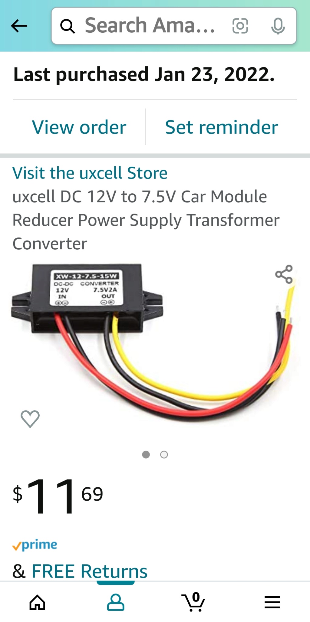

PostSubject: Re: Heated seats   Heated seats EmptySun Jan 23, 2022 11:03 pm
I'm hoping this will do the trick.Heated seats Screen11

PostSubject: Re: Heated seats   Heated seats EmptyWed Jan 26, 2022 5:53 pm
That's brave in my book lol. Do you think I did OK with the step down module pictured a few posts a few posts ago?
