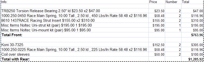

Ok, so a parts list recap.

"The kit and all supporting accessories are distributed by, PSI performance shock inc. the dealers name is BO,and he can be reached @ (707) 938-5664"
Custom Adjustable Front Coilovers for All Years (fabrication required) - Page 4 Prices10
Price and part list. Thats what I'm gettting, but with 350lb front and 300lb rear springs.
Custom Adjustable Front Coilovers for All Years (fabrication required) - Page 4 Empty
PostSubject: Re: Custom Adjustable Front Coilovers for All Years (fabrication required)   Custom Adjustable Front Coilovers for All Years (fabrication required) - Page 4 EmptyWed Mar 06, 2013 11:47 am
And that part list is for 95-99?
Only variable is what spring rates you want?

The entire coil-over package is only 97+. I'm doing other things to convert my front end to the 97+ design. (as did Robo)
Spring rates are variables, and I suppose you could go with a diferent vendor race strut insert if you really wanted...

the kit can be made to fit all years.only difference between series 1 and series 2,is the bolt hole spacing on the strut tab.the spacing is closer together on the series 2.
Ah, so for series one you would just drill the tabs differently. Good to know. I'm still doing the conversion. I want big brakes. cool
