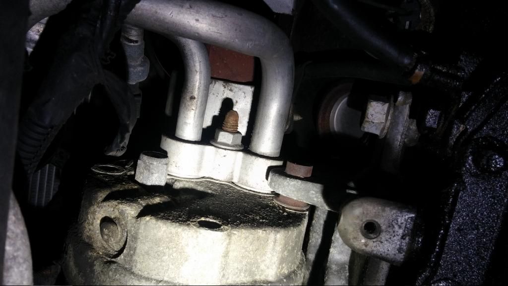

How do the two lines going into the back of the compressor come off? I see there's a nut, but didn't know if I would have to pry the lines out or if they just slipped out after that nut came off.

Take that nut off and pull. You might have to pry a little bit, but don't bend anything.

Cool. I got it broken loose for now. I'll finish this up tomorrow.
