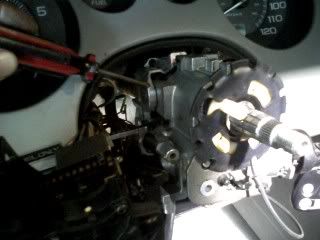

| Hi again, well my husband took it apart to see what was the problem with the steering wheel and yes there was a pin missing and the housing thing where the pin goes in was broke. From all the reading about this, the best and cheapest way to go was to find a steering column from a salvage yard. Finally found one for $100 + $40 shipping. My car is a 97 and the column I bought was a 95. He got it in and hooked everything up. Everything worked (interior lights, antenna, everything electrical, batttery), but the car would not start. Any info on this? | |
zebster Special
Joined : 2007-05-07 Post Count : 4 Merit : 0
| Subject: Re: FAQ: Steering Column Slop, Problems & Replacement Sat May 12, 2007 7:56 pm | |
| Yes since it didn't work he tried mine from the 97. Same thing happening. | |

| this is the culprit for the busted columns, this bracket (which allows the wheel to tilt) literally breaks in two, when too much pressure is applied. its quite a job to replace and new the bracket is close to $100. i have had my entire column out twice, so i have had experience with this. not the funnest thing in the world, but not the worst either. | |
