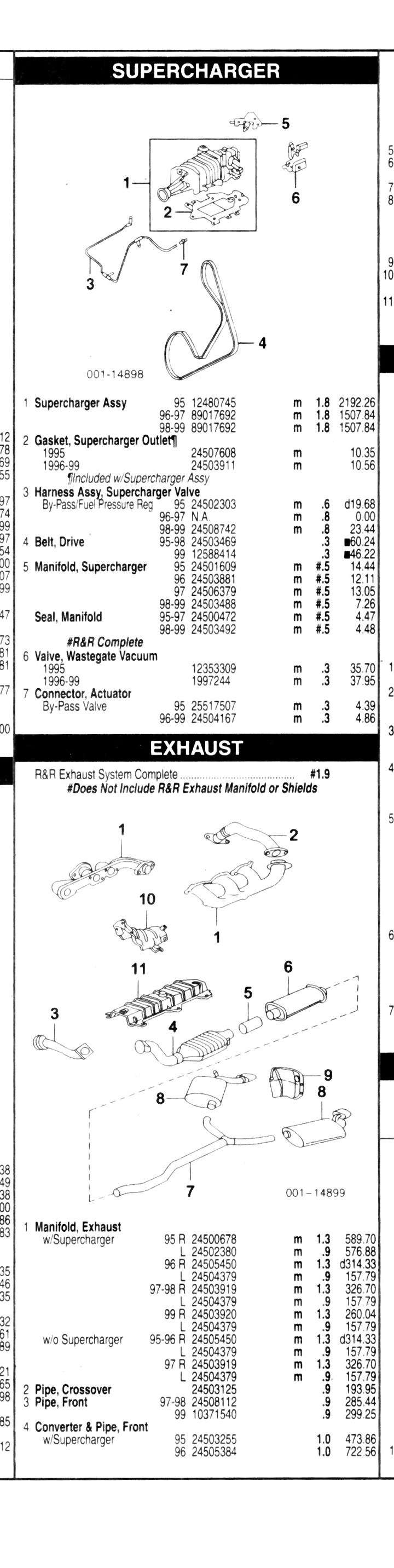

is 1997244 what i should be purchasing?

Based on the location and description, I think so. Don't shoot me if you get the wrong part though. wink
