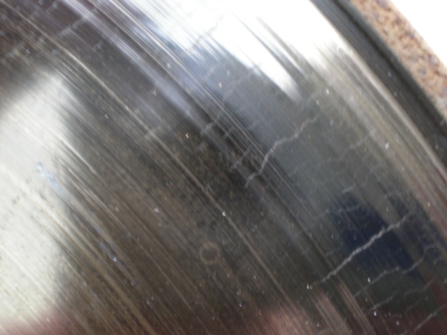

it feels great. i am literally having to relearn how to brake. if i jump on the peddle too hard i have to worry about the car behind me not stopping in time. i feel like i can stop on a dime at low speeds, and high speed braking feels very secure and i havent even tested them to the full potential b/c i dont have abs working.
here are my old rotors and pads full of heat stress cracks compared to the new beasts.
