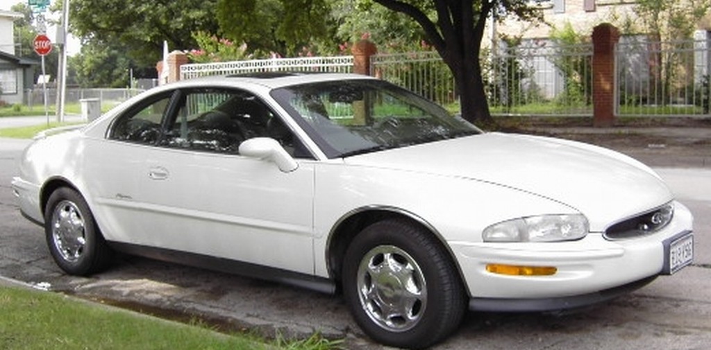

Write-Up: Yellowed Corner Lenses Pict0232
Write-Up: Yellowed Corner Lenses Empty
PostSubject: Re: Write-Up: Yellowed Corner Lenses   Write-Up: Yellowed Corner Lenses EmptyMon Jul 30, 2007 10:45 am
holy headlights batman! that stuff really worked on your car, let us know what you used b/c the plastic-x stuff i got only gets off a few of the layers of oxidized yellow. yours really do look new. so my next question is how long have they lasted like that?

They look much better than mine came out!
