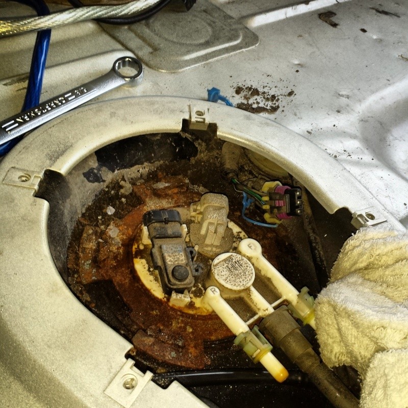

taking a dinner break now..
My lock ring is rusted bad and will not budge. I am trying to tap it with a screw driver and hammer but have only gotten it to move maybe 1mm. It's on there REAL tight and not going anywhere fast.
I just did some searching and there is a tool - a fuel sender spanner wrench J 39765 to get the ring off?
Do i need that or is mine stuck on there unusually well?
Bout to finish dinner and go back out to beat the crap out this thing.
Write-Up: Fuel Pump/Tank Sending Unit Replacement - Page 5 Empty
PostSubject: Re: Write-Up: Fuel Pump/Tank Sending Unit Replacement   Write-Up: Fuel Pump/Tank Sending Unit Replacement - Page 5 EmptyThu May 28, 2015 7:42 pm
Unusually well. Mine came off last year without any real issues. Some just get STUCK.
PostSubject: Re: Write-Up: Fuel Pump/Tank Sending Unit Replacement   Write-Up: Fuel Pump/Tank Sending Unit Replacement - Page 5 EmptyThu May 28, 2015 10:44 pm
Took me longer than I thought and I literally had to beat the shit out of the ring but it finally gave up and I got the module out.

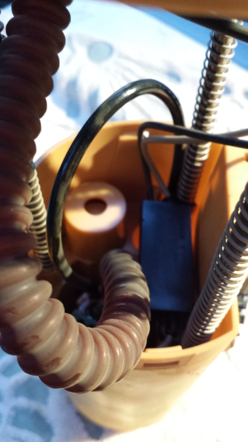

There was a small black box between the pump and the power lines. The intense write up shows this being reinstalled. I got a new fuel level sensor cause mine was toast and it did not have the black box on it's harness.
I chose to keep the black box and only use the leads to the sensor from the new sensor harness.

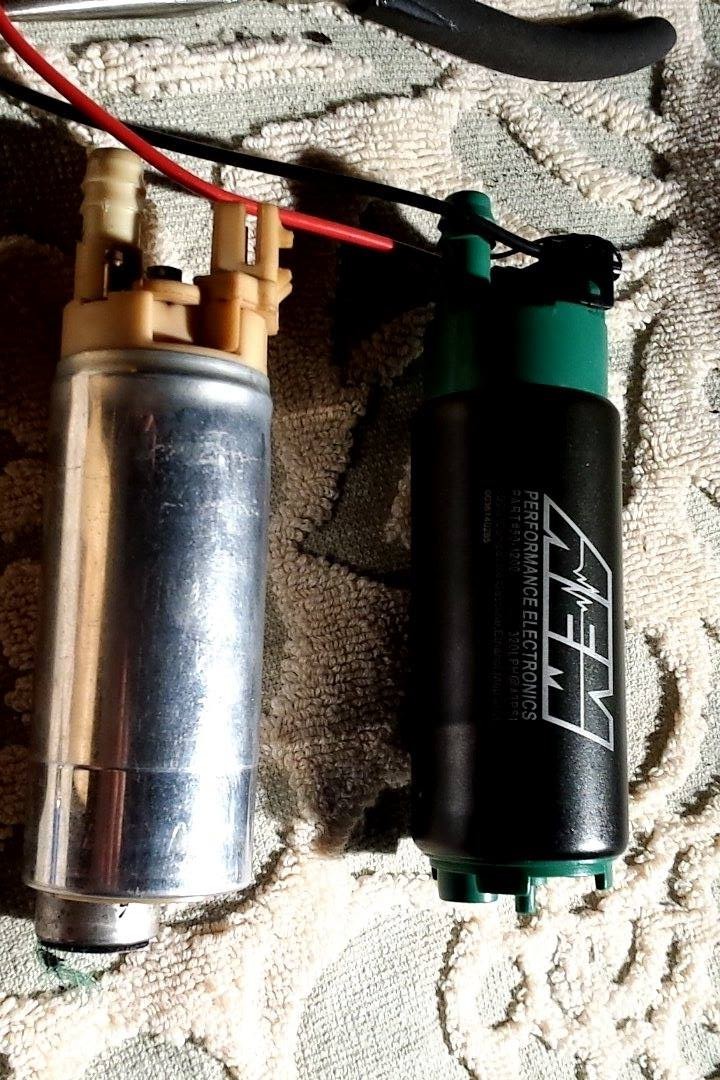

here's some pix n shit of my install from last weekend before i lapse and never say anything about it again.
The most difficult part of the entire job was getting that lock ring off. That sucked.
Beat the shit out of it with a hammer and chisel for 2 hours straight. I dont mean some taps here and there. I was unleashing rage into the back of the chisel. Had to even soak it in pb blast and let it sit for a minute.
Write-Up: Fuel Pump/Tank Sending Unit Replacement - Page 5 Img_2011
Once I got the module out, the rest of the job was fun.
Write-Up: Fuel Pump/Tank Sending Unit Replacement - Page 5 20150510
Anyone know what the black box is in the power line to pump? Didnt look like there was a way to open it or disconnect it. My replacement fuel level gauge harness did not have the box on it but the intense fuel pump write up showed them leaving it on so I left it how it was.
The AEM pump fit perfectly into the stock sleeve and into the module. I used the stock main line too. I followed the intense write up and pried the nipple off the old pump. (that was the 2nd suckiest part of this job) and ran the venturi line back to the pump.
