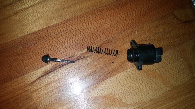

So my car doesn't like to idle unless it's been running for awhile. I bumped up the timing and idle RPM which made no difference at all. On a fresh start it will die down to about 500 RPM for a second or two and then stall altogether. After it's been running/driven for a little while it will idle just fine, no problems. If I just give it a little gas and hold it the idle will raise and hold steady, and normal/hard driving is just fine. Fuel trims aren't perfect but it has idled better with worse. Voltage is about 13.5 during normal driving and idling which seems low to me, drops into the 11s/12s when the idle drops to 500 and it dies. Ideas? I'm thinking of trying the voltage booster mod...
Edit: Pulled out my IAC and found this:
Write-Up: Fuel Pump/Tank Sending Unit Replacement - Page 6 2015-025
Write-Up: Fuel Pump/Tank Sending Unit Replacement - Page 6 K3nm7710
Slapped in a new one and it's all better now.
