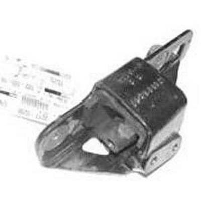

| It's cheaper there but i needed it ASAP b/c i'll be moving soon and wont have a garage to work in for a little while.
Take notes when you do yours in case i missed something. i was doing a lot of trial-n-error removing bolts trying to find an easier way to get it out. _________________ 1996 with 254k miles, L32 4" FWI -> ported N* -> Ported Gen V w/3.0" Pulley, Stage 3 Phenolic I/C, ZZP FMHE, 1.84 RR, Headers and 3" pipe to mufflers, F-body brakes, and lowered on Eibachs. -RIP AMG C400 White on black. Stage 2 w/E30 - 11.9@117 -daily | |

| Boy, the mount sure doesn't look like the drawing in the manual... I wonder if the expensive, OEM replacement comes as a complete, bolt-in unit. | |
Mr.Riviera Expert
| Subject: Re: Write-Up: Filled Rear Motor/Transmission Mount Mon Jul 05, 2010 5:08 pm | |
| driver side complete unit is available form AZ for $102 What does the manual look like? maybe the 96 is different than the rest of them? _________________ 1996 with 254k miles, L32 4" FWI -> ported N* -> Ported Gen V w/3.0" Pulley, Stage 3 Phenolic I/C, ZZP FMHE, 1.84 RR, Headers and 3" pipe to mufflers, F-body brakes, and lowered on Eibachs. -RIP AMG C400 White on black. Stage 2 w/E30 - 11.9@117 -daily | |

Thanks for the extra photo, I'm sure it will help others along the way. It was my mistake, I would have sworn that I read yours as 1998 last night... that's what I get for skipping my Vitamin V. Yes, '95-'96 and '97-'98 are different because of the different trannies - '99 even uses a third one that is the cheapest! To add to the confusion, GMpartsdirect lists 3 different mounts ranging from $50 to $200, but they use the same diagrams for all years... The only good thing I see in all of this is that the "Drive" mount, which takes most of the abuse, is the front one, which is the easiest to change. So now I have another question: Do all years use the 4th mount on the drivers side? | |
Mr.Riviera Expert
| Subject: Re: Write-Up: Filled Rear Motor/Transmission Mount Mon Jul 05, 2010 7:48 pm | |
| my 96 has a 4th mount by the EBTCM. Also note that rockauto lists the same rear mount for 95-98 rivieras; anchor part 3065 that Aaron posted earlier. The 99's have this listed for the "rear left" : _________________ 1996 with 254k miles, L32 4" FWI -> ported N* -> Ported Gen V w/3.0" Pulley, Stage 3 Phenolic I/C, ZZP FMHE, 1.84 RR, Headers and 3" pipe to mufflers, F-body brakes, and lowered on Eibachs. -RIP AMG C400 White on black. Stage 2 w/E30 - 11.9@117 -daily | |
| Subject: Re: Write-Up: Filled Rear Motor/Transmission Mount Fri Jul 09, 2010 12:35 pm | |
| I just received mine from Rockauto, looks just like the picture: I'm going to fill it with epoxy before installing. _________________ '05 GTO 6.0L • 6-spd • 95k miles • 0-60: 4.8s • 16.9 avg MPG • Nelson Ledges Lap: 1:26'95 Celica GT 2.2L • 5-spd • 165k miles • 0-60: yes'98 SC Riviera • 281k miles • 298 HP/370 TQ • 0-60: 5.79s • ET: 13.97 @ 99.28 • 4087 lb • 20.1 avg MPG • Nelson Ledges Lap: 1:30 3.4" pulley • AL104 plugs • 180º t-stat • FWI w/K&N • 1.9:1 rockers • OR pushrods • LS6 valve springs • SLP headers • ZZP fuel rails KYB GR2 struts • MaxAir shocks • Addco sway bars • UMI bushings • GM STB • Enkei 18" EV5s w/ Dunlop DZ101s • F-body calipers EBC bluestuff/Hawk HP plus • SS lines • Brembo slotted discs • DHP tuned • Aeroforce • Hidden Hitch^^^ SOLD ^^^ '70 Ninety-Eight Holiday Coupe 455cid • 116k miles^^^ SOLD ^^^ | |

| Chris, if you have a car that is 12 years old with 100k miles on it, chances are (at least) your rear trans mount is shot. Both my front and rear were no good when I bought my car with about 76,000 miles on it. I waited untill I had my trans rebuilt to have them replaced. At that time, they weren't available aftermarket and I didn't know any better so i paid retail at $300.00 each. Figured while the trans was out for O/H it made sense to spend another $600.00. What a friggin dope i was.
My car showed signs of the worn mounts before the trans issues by the engine moving around the engine bay during acceleration and decelleration. Serious fore and aft movement and some banging when accelerating hard, but just the movement was enough to know that they were worn out. Once the trans was out of the car and you could look closely at these mounts, it didn't take a second for me to tell the shop to go ahead and buy new ones, even at the price i was quoted. I was told they were not available other than through the dealer and i made a couple of phone calls to verify that.
You all are lucky that the internal parts, the rubber and center bushings are now available for what you would expect to pay for a rubber mount. Just replace them if there is a question. You will be glad you did. And what I have found out from this site is to fill the gaps with the 3M window urethane that has been mentioned several places on here before.
The reason being is even the brand new mounts are made so flexible for a luxury car feel that they don't quite do it even when new. Meaning they still allow the engine to rock back and forth too much. This summer, while doing a bunch of other preventive maintenance to the car I'm going to fill the rear and front mounts with that 3M window seal, urethane, and let it cure overnight and hope i haven't waited too long to do it. Preferably the surfaces should be clean of all oil and dirt before applying.
If you buy new mounts, buy this stuff and fill the factory voids with it before installing the mounts and let sit overnight, you'll be glad you did for an extra $10.00 a tube.

I started hearing a "clunk" sound during mild cornering. It sounded like there was a large socket rolling around under the hood. I took the car in for inspection and they pointed out a bad right side ball joint, and the failed rear mount. The tech took a crow bar and lifted the engine to show how loose it was - i'm not sure there's much rubber left insulating anything. Lots of movement. I've since replaced both ball joints, but still have the clunk sound, so hopefully it's the mount. _________________ '05 GTO 6.0L • 6-spd • 95k miles • 0-60: 4.8s • 16.9 avg MPG • Nelson Ledges Lap: 1:26'95 Celica GT 2.2L • 5-spd • 165k miles • 0-60: yes'98 SC Riviera • 281k miles • 298 HP/370 TQ • 0-60: 5.79s • ET: 13.97 @ 99.28 • 4087 lb • 20.1 avg MPG • Nelson Ledges Lap: 1:30 3.4" pulley • AL104 plugs • 180º t-stat • FWI w/K&N • 1.9:1 rockers • OR pushrods • LS6 valve springs • SLP headers • ZZP fuel rails KYB GR2 struts • MaxAir shocks • Addco sway bars • UMI bushings • GM STB • Enkei 18" EV5s w/ Dunlop DZ101s • F-body calipers EBC bluestuff/Hawk HP plus • SS lines • Brembo slotted discs • DHP tuned • Aeroforce • Hidden Hitch^^^ SOLD ^^^ '70 Ninety-Eight Holiday Coupe 455cid • 116k miles^^^ SOLD ^^^ | |

| I was able to pick up mine from autozone. They had to order it but it was pretty cheap. As i said earlier in the thread i filled the voids with window weld and it has been holding up VERY well. i actually have a little more cabin vibration now that all my mounts are semi-poly. Not near as bad as my friends regal with all poly mounts but i do notice a vibration at certain rpms.

| Nope I actually had to cut the tube open because the nozzel was clogged from the last mount i filled.
I took gobs of it with my hand (gloves are a must) and packed it in the voids squishing out the air and then as it started to harden i smoothed the ends for aesthetics. _________________ 1996 with 254k miles, L32 4" FWI -> ported N* -> Ported Gen V w/3.0" Pulley, Stage 3 Phenolic I/C, ZZP FMHE, 1.84 RR, Headers and 3" pipe to mufflers, F-body brakes, and lowered on Eibachs. -RIP AMG C400 White on black. Stage 2 w/E30 - 11.9@117 -daily | |
